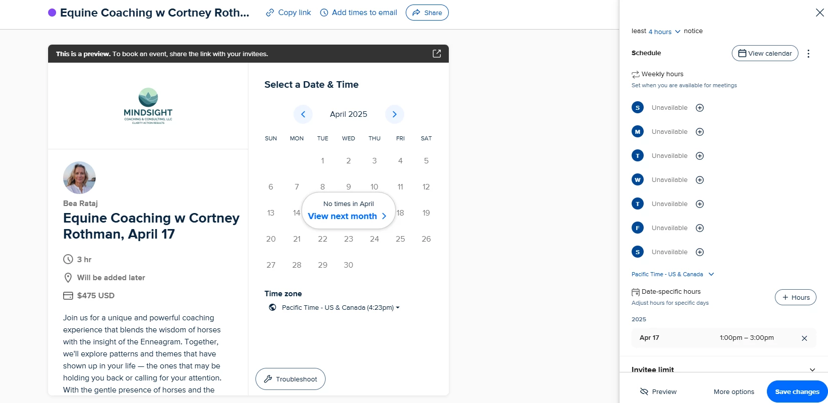

Hi there, I tried what you suggested and when I go to the booking page, it says “No times in April”. But I did specify April 17, 1-3 pm. What did I miss?

Often these ‘no available times’ messages are caused my another event already on your connected calendar during that day. If you go to your meetings tab, you can see all of the meetings Calendly has scheduled for you. Also, I would just take a peek directly at your connected calendar and make sure there isn’t a meeting between 1pm and 3pm (the time you’ve constricted Calendly for scheduling this event). If you are still having issues scheduling a meeting after that, reach back out here and we can keep the conversation going.

I followed the above steps. But it still didn’t work. Then I found that the times people could book were set to 30 minutes. I made that 3 hours on my event day.
Then I increased my Availability time to 4 hours (my event is 1-3 pm; I made my availability 1-4pm). Then finally it worked.
