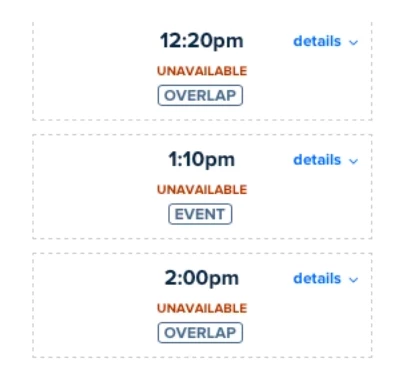

Thanks so much for your help on this. I am still having an issue though.  I am using one to one meetings and I changed all the free / busy rules on each calendar for each cart to meeting name matches exactly. I am still getting these instances on calendars that have no booking at all. (photo below) I know event means its already booked. But I am getting overlaps still. Any advice is appreciated. Thank you. again.

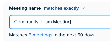

Just to confirm, does it show that there are any upcoming meetings when you configure the free/busy rule? It should look like this:
If not, can you send me a screenshot of whats showing up for that time, as well as the configured rules for this meeting? Let me know!

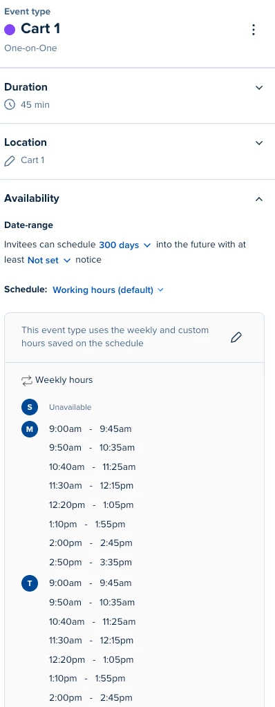

Here are some screen shots.
I set this up as 1 to 1 meetings

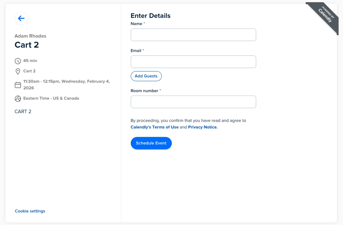

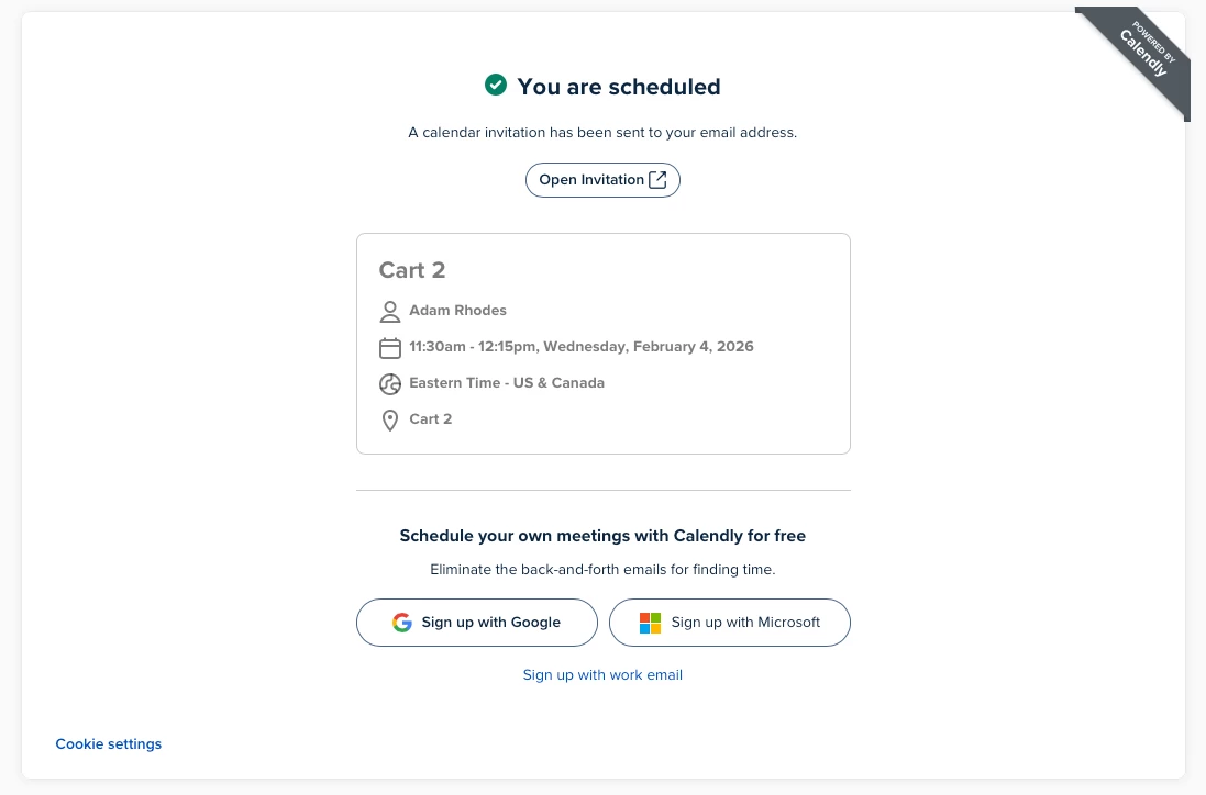

Here is what it looks like from the client side. Is this what you meant?

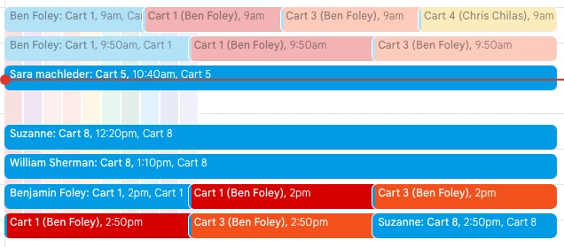

My apologies, to clarify, I mean the Calendar Event on your connected calendar - What does it show up as?
Something like this for example:
Let me know!
Adam42828Author
January 30, 2026
Here you go. Is this it?
