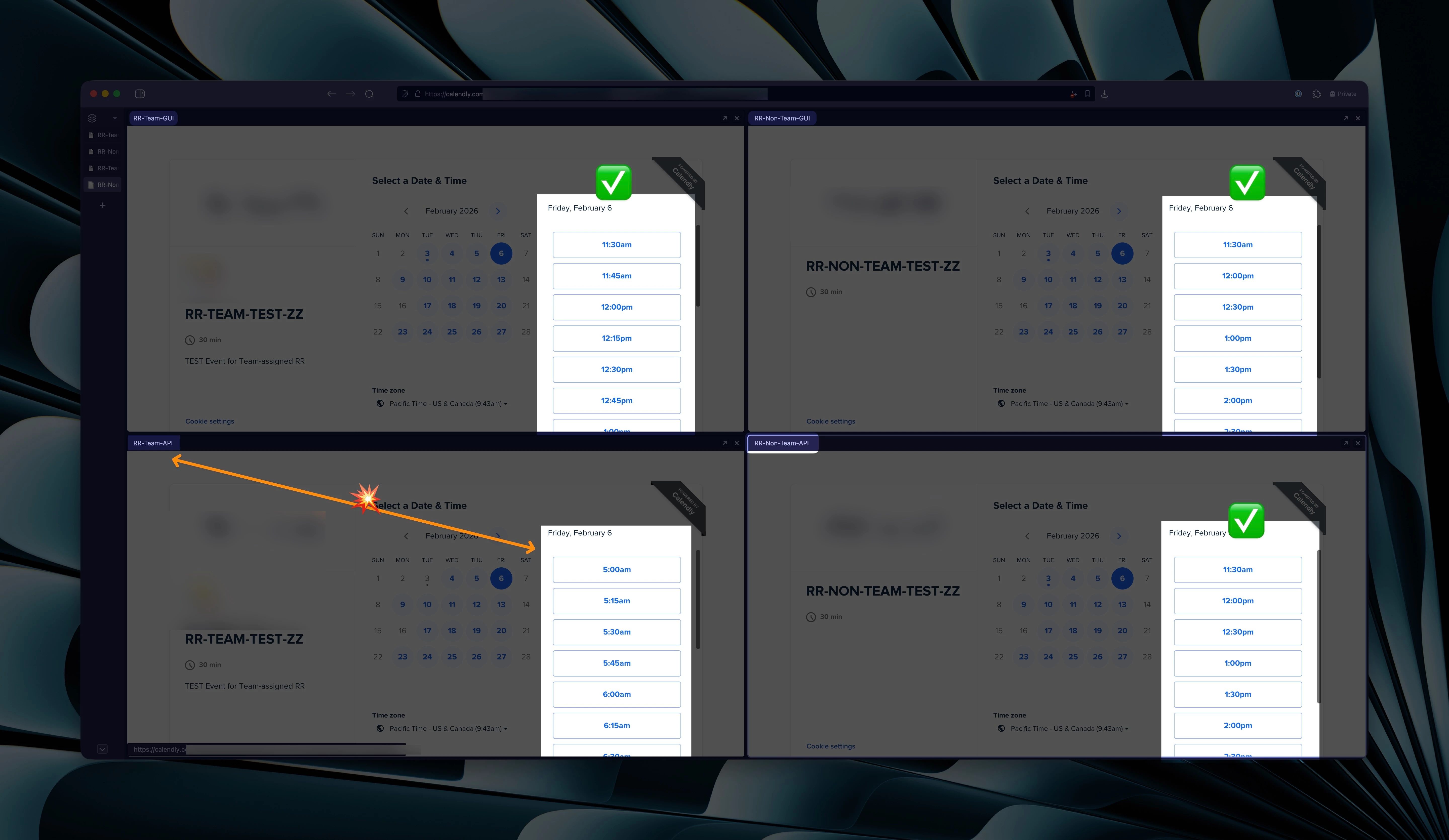

Feb 3, 2026 10:08 PM UTC
Following up here, I think there’s a bug with the /shares endpoint.
  • When getting a one-time link from the /shares endpoint for a Round Robin Event type assigned to a Team, passing no override values in your request (so just the event URI):
    • Expected behaviour:
      • The host availability in the target Event Type is used for the one-time link obtained from the /shares endpoint.
    • Actual behaviour:
      • The scheduling link ignores the availability of the target event.
Here is an image demonstrating the bug in that specific flow.
  • Team event via Calendly web UI (top left)
    • Correct availability
  • non-team event via Calendly UI (top right)
  • Team event via /shares endpoint (bottom left)
    • INCORRECT AVAILABILITY
  • non-team event via /shares endpoint. (bottom right)
This behaviour is both unexpected, and runs contrary to the documentation for that endpoint.
I have yet to hear back from Calendly Developer Support about whether this is the intended behaviour or not.
But if you are using the /shares endpoint for any Team events, this is definitely something to look out for because it has caused us some headaches both with mis-scheduled calls, and dev time investigating this.
Hopefully this post helps save someone else some time and hair loss!
