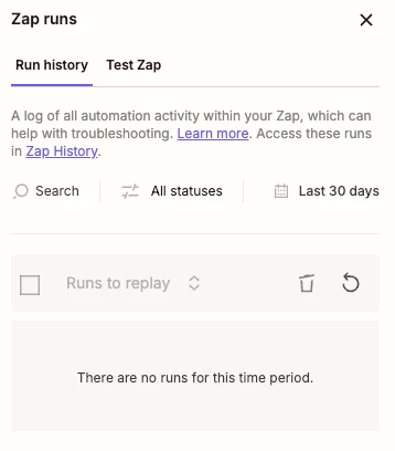

Hm, I’m not sure what could be the cause here. Do events in Calendly show as rescheduled when they’re moved in the Google Calendar? Additionally, do the Zap Runs show any errors for previous times?

And the Zap Runs doesn’t show any errors, because the Zap is never triggered in the first place. As I said, it’s as if rescheduling the event in Google Calender broke the connection between Zoom and Zapier, so the Zap never runs.

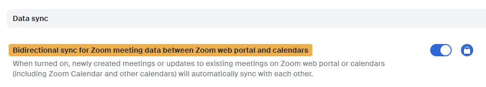

I found this setting in Zoom:
I will try enabling it and see if this fixes the issues with the bi-directional sync 🤞
Feb 6, 2026 5:09 PM UTC
Sounds good! Let me know!
