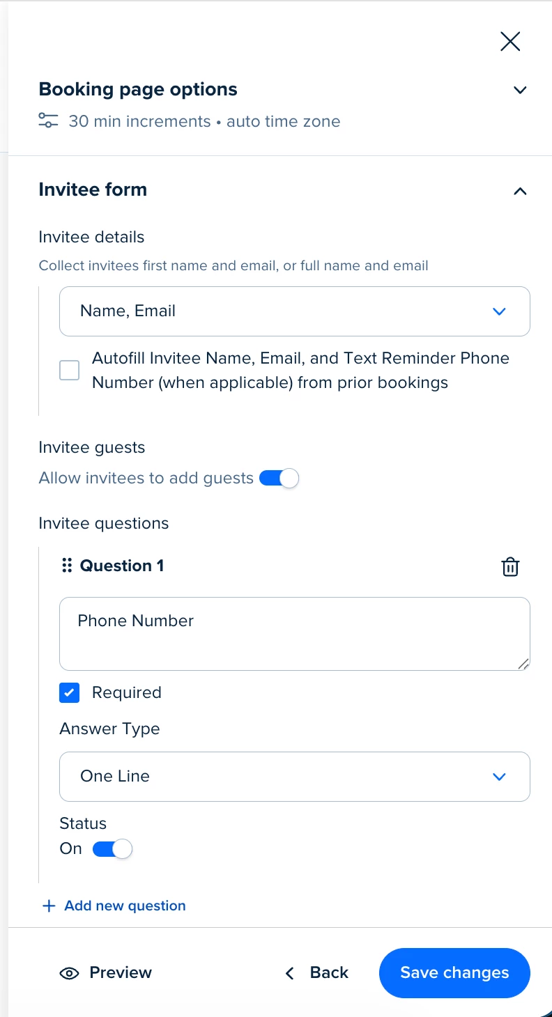

Thank you everyone for your input. Based on the knowledge provided, I’m now able to get the 1 defaulted into the phone number (Thank you!), however, the + before the 1 does not default even though I included it on my link.  "https://calendly.com/my-calendar/?location=+1"
Feb 5, 2026 10:43 PM UTC
​@Ed13213 - great callout! The location input works differently for some reason, so the “+” will not appear like in the custom questions.
​@Sonia83470 - I’ve highlighted the code you need to change for the inline widget below; when you copy your code you’ll just need to add the “a3=+1” (or whichever answer corresponds to the input)

Omg can you please help me do this universally so it’s not needed for every single event?
