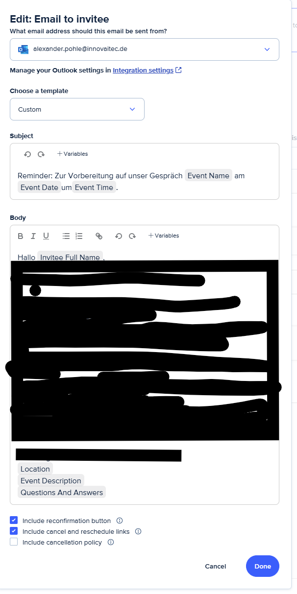

Hello guys,
i have an issue with the subject line. We send out a new mail with a subject.
But the subject includes utf8 and it shows uncoded subject now.
How it looks in outlook:
how it looks in gmail:
How can we solve this?
What i tryed - typed in all new in subject line and hoped the utf will be removed.

Hi,
i have 2 workflows with the same issue :)
both created with different timestamps but i can do it again and test it. give me a few seconds
  • Author
  • Community Member
  • June 12, 2025
workflow newly created - same issue - maybe it is an issue with äöü - i will check it fast
  • Author
  • Community Member
  • June 12, 2025
double checked it now - new workflow without and with special char. same issue. utf8 formation in subjectline is the issue.
Looks like that outlook / MS365 can not translate utf8 in subject line. How can i disable this in calendly?

Understood, thanks for checking all of this!
Could you send me a screenshot of whats configured in Calendly for both the working and non-working workflow? I don’t believe there is a way to disable this in Calendly, so I can report this for you on your behalf.
Once you send it over, I can take care of it from there.
  • Author
  • Community Member
  • June 12, 2025
Hi, sure i can.
but i checked some more.
The initial Appointment mail - fine
The follow up mail - broken
cancle appointment - fine
does it matter which eventtype - nope - all are affected new and old.
created a new workflow - mail to host without variables- works
changed to mail to invitee without var- works
added  1 var - utf issue appears :)
i changed it back to mail to host - and added a var - no issue.
so it looks like its based on send mail to invitee + using at least 1 var.
there is no special config. Just the function and selfwritten text - not ccopied + 3-4 var.
You need still the configuration for it?

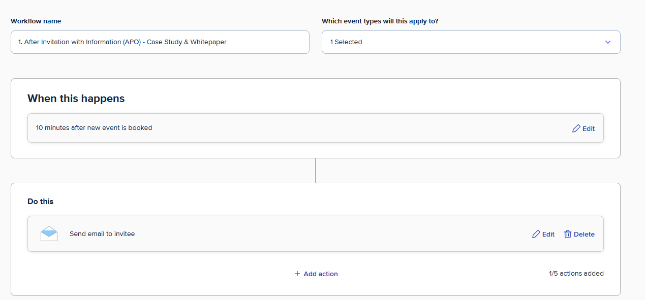

  • Author
  • Community Member
  • June 12, 2025
Hope this should work :)
  • Community Manager
  • June 12, 2025
Thank you so much, I’ll get this over to our team so they can investigate - Just to confirm, the Workflow you shared in the screenshot is the one that shows up incorrectly in Outlook, right?
  • Author
  • Community Member
  • June 12, 2025
Yes, all workflows have the same issue with mail to invitee. It makes no difference with the content. Only if you use a var its broken when use the fuction send mail to intivee.
all workflows with send mail to invitee are broken.
